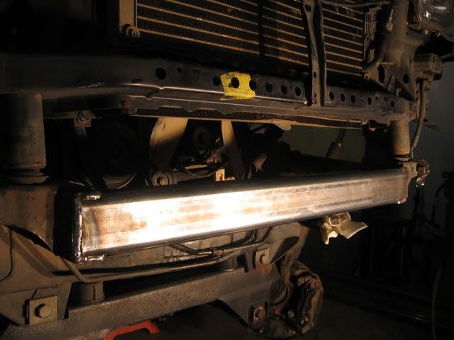

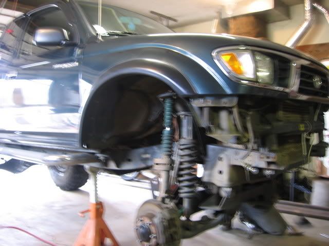

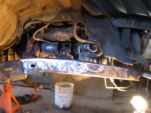

here is the build up i've been doing on my buddies truck... he wanted to do the all-pro kit but after reading all the troubles with it, we decided to just peice together our own...
ballistic fab mounts
1 1/4 heims from oregon motorsports
walker evans 12" coilovers (allpro ones from their kit)

Looks good. Only thing I see really is that that suckers going to be tall with the upper and lower coilover mounts that low and high respectively- even with those WE's.
Rear crossmember looks stout.

Veeeeerrry niiiice
Some good work there, looks pretty stout all the way around.
Although, do you plan on doing an engine bar to connect the coilover hoops?
Oh, and I don't think your links and heims are big enough:flipoff4:

engine bar is on the list for tonights stuff to do...
i thinks the heims are just right...
