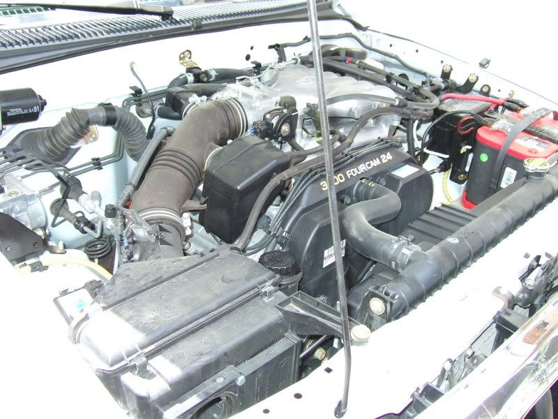

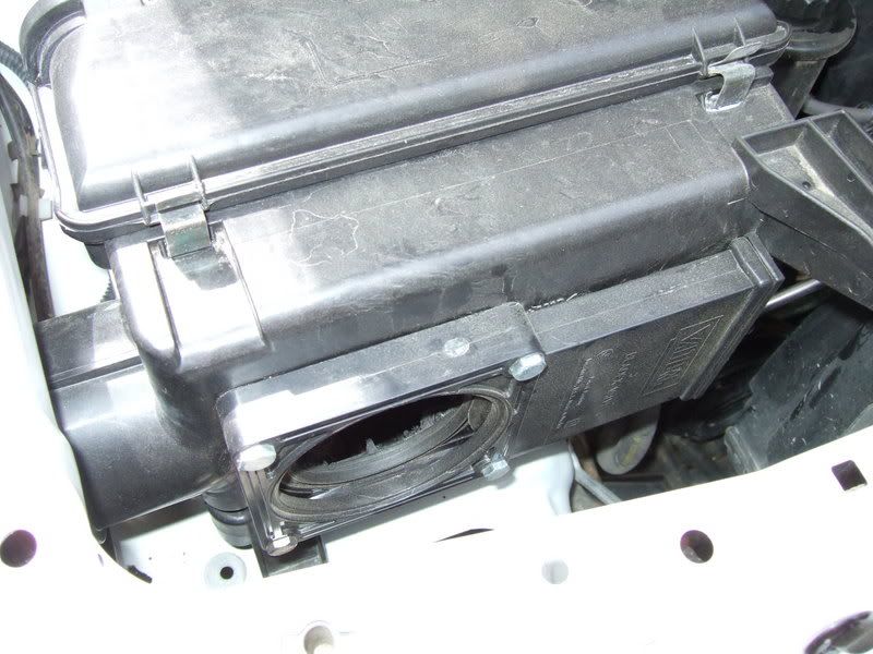

I have never seen this before so maybe I'm the first. I was working on my RV the other day replacing a dump valve and thought about the Deck plate mod I was reading about a few days earlyer. Thought this would work better and would be easyer to open and close. What do you guys think?

I put a thermometer inside the air cleaner housing and drove around with it open and closed. It was the same temp. I did this because I wanted to let more air in for when I put the supercharger on instead of the deck plate mod.

ever heard of airflow? theres nothing in front of the airbox except the headlight. sure at 1 mph it might get hotter but at speed???

According to my Scangauge, which picks up directly off the MAF, the deckplate mod increases the temps on the freeway by about 10 degrees, 20-30 degrees on the city streets, and when I was towing a load, I was seeing a 50* temp increase...
I also get better gas mileage with it plugged...
12,213 Posts
I thought so too till I installed the ScanGauge. Deckplate is plugged more now till the Outlaw intake gets installed.

I was ordering the 7 injector kit and AFR calibrator for when I install my suppercharger and was asking [email protected] what else I should do. He said to do the deckplate mod and a muffler. And I just came up with this instead.

i have a scan gauge and a deckplate and get different results. anything about 30-40 mphs, regardless of deckplate open/closed, the intake temp is the same as ambient temp (give or take 1-2 degrees). at slower speeds, it is much hotter than ambient temp.

For me the deckplate is a crock of ****. I tow my wakeboarding boat during the summer, and how am I gaining any hp and torque with a 50 degree intake temp rise???
Even if it does provide a little bit of horsepower, it's not worth it to have the increased temps getting sucked into the motor, nor having the 1mpg worse.
