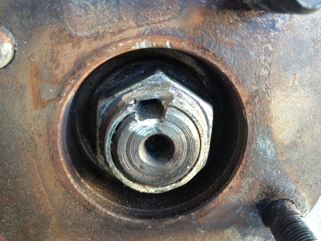

Any tips for getting them off? We've tried heat, we've trid brute force with a 3/8ths breaker bar that broke, and we've tried cutting the nut but stopped for fear of messing up the shaft.
Installing a twin stick on my truck and we're dead in the water if we can't get the front output off.

You said you tried cutting. Wha'd you use? Maybe a dremel would be good since you can control it fairly well. Just cut it enought to where you can get a chisel in the crack on then strile that with a hammer. Hopefully that'll get a hairline crack in the nut and you can get it off. Be careful though..

I had to replace the front output seal on my 97 a couple weeks ago and that nut was the hardest fastener I have ever had to remove. It looks like like you have the staked part taken care of it though from the picture you posted. Just so you know I had to use a 2ft 1/2 drive breaker bar with a 4 ft cheater bar and put it all the way over out the passenger side of the truck and put a floor jack under the socket so it couldnt wobble off, then I had to JUMP on it to break it loose. Make sure you get someone to stay inside the truck with it on and just ahve them stand on the bakes. Oh yeah and the threads of the nut are coated with loctite from the factory so that keeps it on there that much better.
Definatly get a 1/2 breaker bar!

1/2" breaker bar with a cheater bar on top of it. You may have to put two holes in a piece of flat bar and bolt it to the flange and use that to immobilize the flange.

Air Tools.
Any good 1/2" impact will spin that nut right off.

I would grind some of the material off the nut to weaken it's grip and use an impact gun as Frank suggested.
You said you used heat? Not good man! Never use heat on anything heat treated. Even as little 400-500 degrees can alter the temper in the steel. Many steels are tempered right in that range.

We got the nut off finally. We just weren't hitting it with our purses hard enough.
