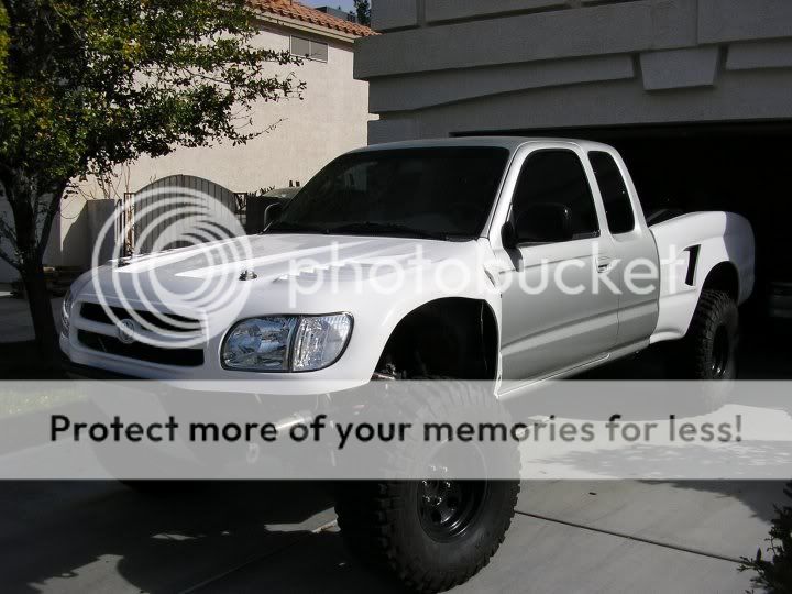

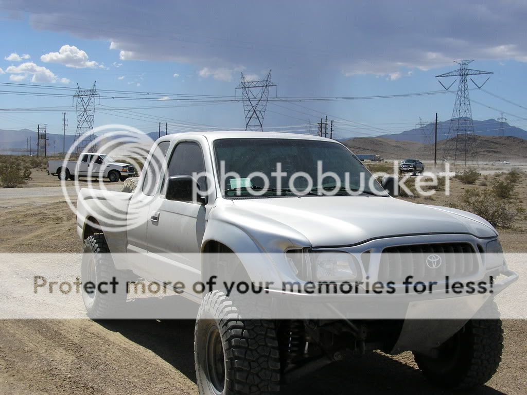

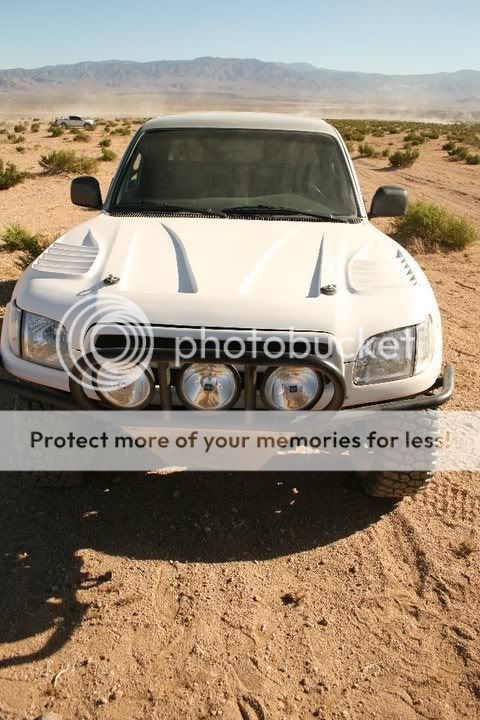

Picked up the truck in July 2009 with a Camburg LT kit, SAW coilovers and bypasses up front, Deaver prerunner pack with 14" SAW threaded body shocks mounted via a Solo Motorsports built bedcage. Front and rear bumpers also Solo built, sitting on 35" Nittos.
Step 1....Removed stickers and added new 33" BFG KM2s...
#3 · (Edited)

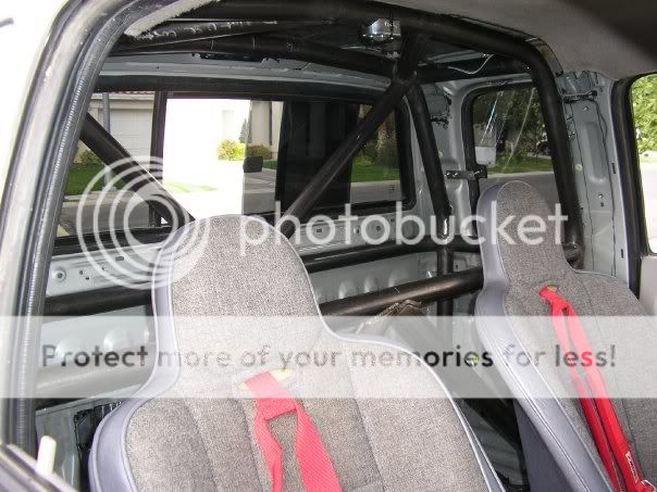

Decided to start adding a bit of cab cage to protect the occupants in case I had even less talent than I thought! Work done by Jared at Vegas Steel in Las Vegas...

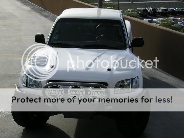

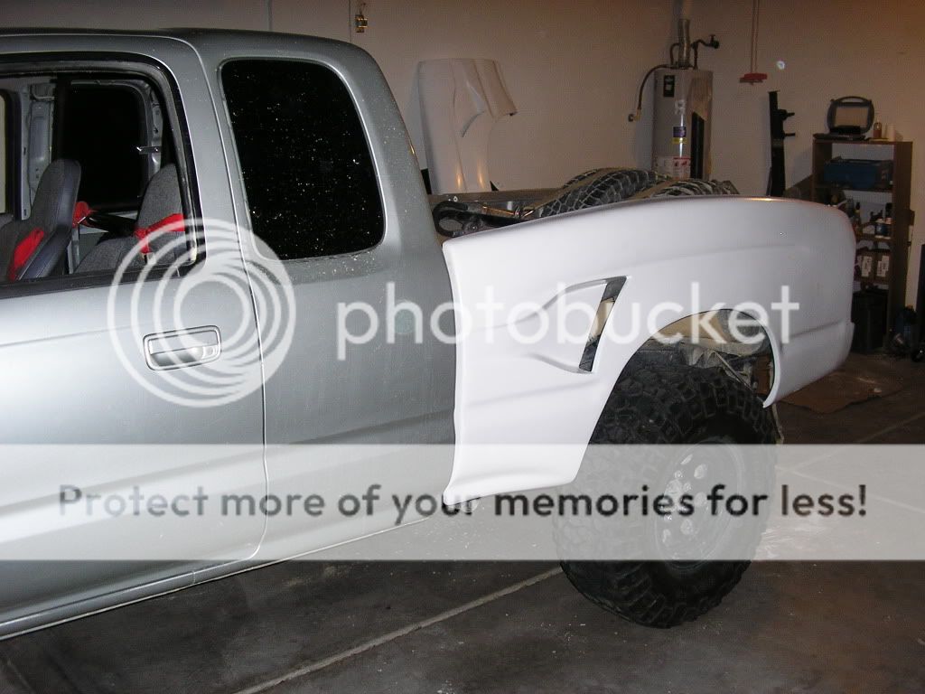

Wanted to change the look of the truck to start fresh and give it a new identity to make it feel like "ours" so we did a little cosmetic makeover starting with some Glassworks TT Bedsides...

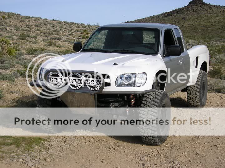

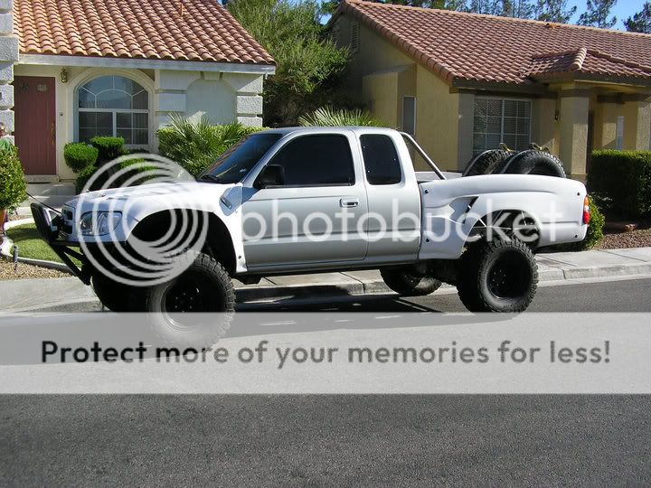

Then decided to add a Fiberwerx Tundra Conversion clip. The story goes, I picked up the orginal clip from Kartek and quickly discovered that it was warped pretty badly. The clip didn't line up with the mini fenders and basically wasn't fixable without a significant level of work.
I contacted Fiberwerx and they could have told me to pound sand but didn't. They looked at pics, agreed that it was off, and expressed an interest in re doing the mold. I offered to take my truck to them to make the new mold. Jason and co. redid the mold, installed the new clip, and brought the truck back to me in Vegas.
The resulting product was excellent in my opinion and I have nothing but great things to say about Jason and everyone I've dealt with over the last two years at Fiberwerx...

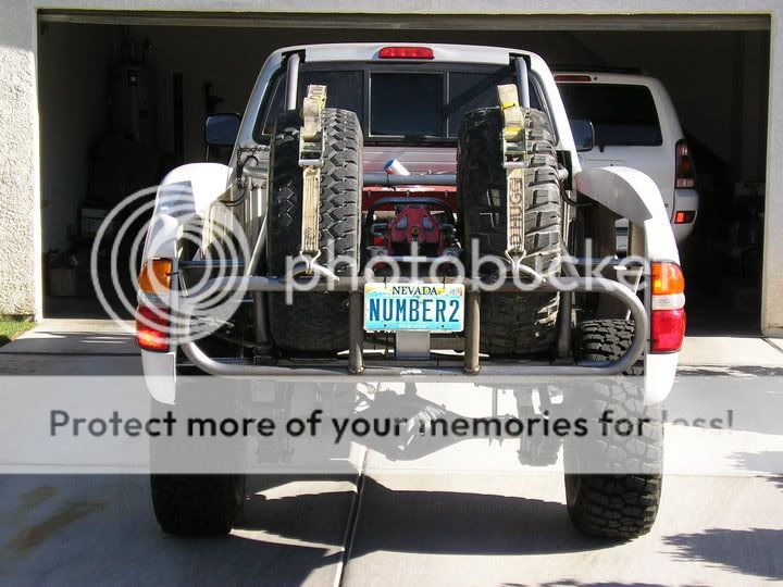

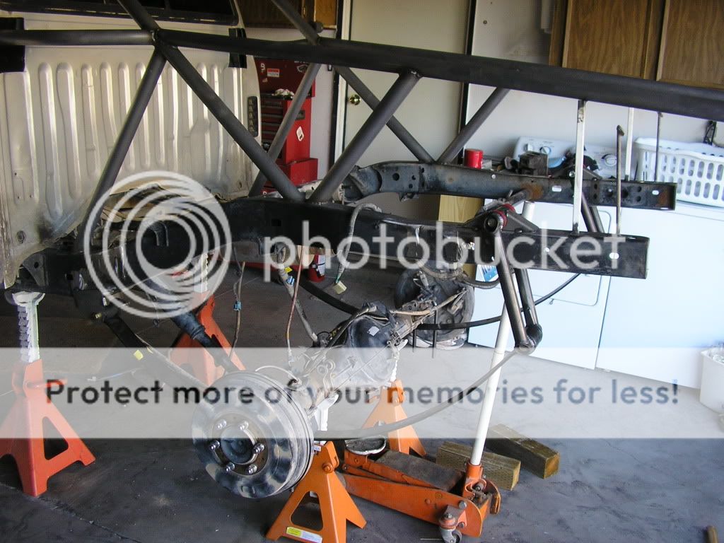

Had to cut off the Solo built front bumper in order to fit the clip so I managed to convince my friend Khris (sirhk100) to help me out. After serving as my sounding board, answering questions, keeping me from making ridiculous buys, etc, he became the primary fabricator of the truck...

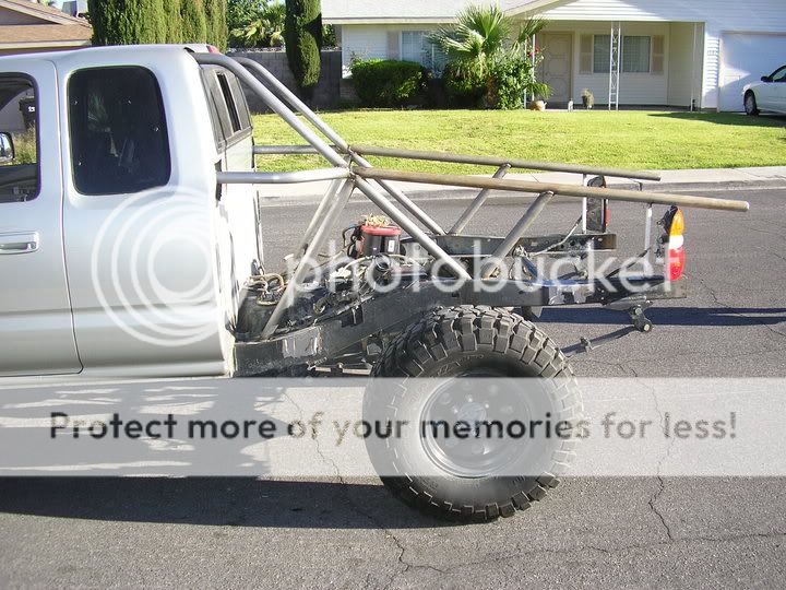

A few months prior, I had the good fortune of winning a set of All Pro Baja Leafs thanks to a generous give away they did on this forum. Knowing that adding the leafs would involve more, they sat in the garage for a bit until Khris offered to do the work plus add a bedcage for next to nothing.
So with that said, I picked up all the appropriate hardware from Total Chaos and we started the first major fabrication upgrade of the the truck...
Then the All Pro Baja leafs...

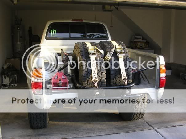

Then got a little crazy and added a 32 Gal Jaz Fuel Cell and King 2.5x18" Triple Bypasses for good measure...

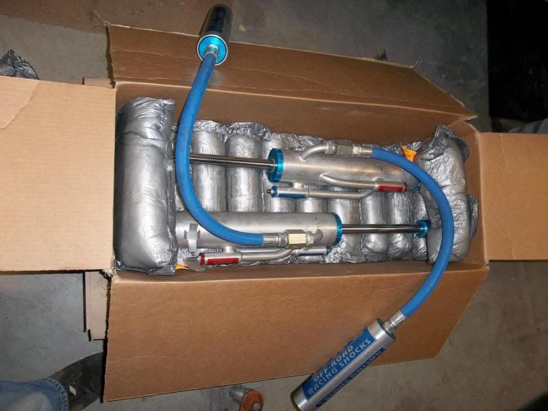

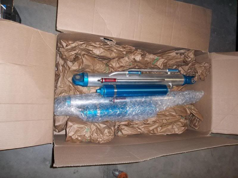

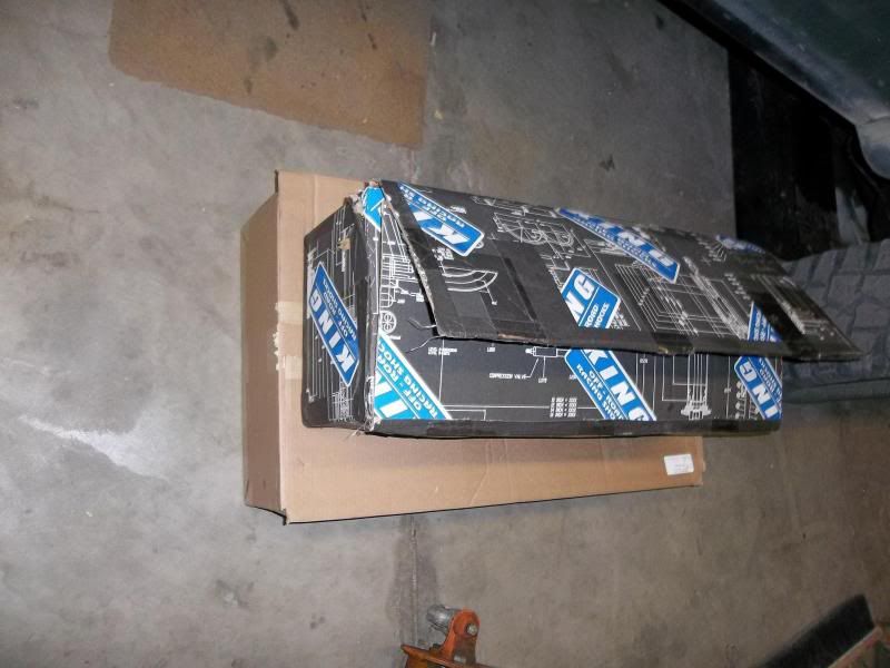

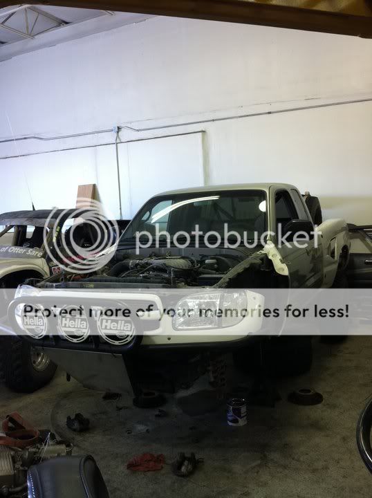

And THAT brings us to the present! Currently the truck is having a custom full race kit built at MCM Fab and Design in Las Vegas, NV. After it's completion scheduled for later this month, the truck will get gutted to make way for an engine cage and 2" cab cage.
The front suspension will get King 2.5x10" Race Series Coilovers and 3.0x10" Triple Bypasses. The King 2.5x18" triples in the back will be replaced with 3.0x18 4 tubes. We'll be adding a Schriener built 35 spline full floater and adding plenty of plating to strengthen everything up.
The cab will get a makeover with a Fiberwerx dash and console decked out with Momo wheel, NRG disconnect, Auto Meter gauges, intercom and radio from Rugged Radios, GPS, and a pair of sexy ReplayXD1080s to capture all the action.
The current plan is to have the bulk of the fabrication done by the end of spring to allow for fine tuning, shock valving, etc through the summer. Will add pics as we go and update our Facebook often.

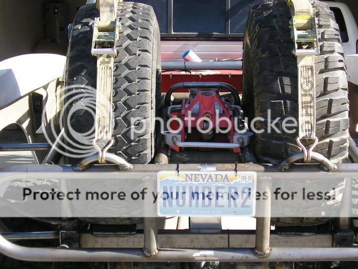

LOL, and you just had to use the pictures where the cell was temporarily ratchet strapped in place didn't you! I'm actually planning to redo those current hold downs too btw... They work but they've never been really appealing to me at the same time.

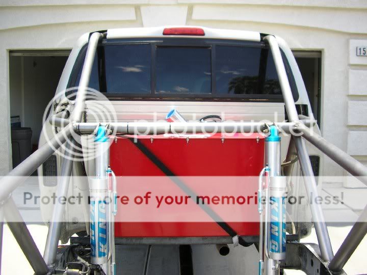

#12 ·
Truck looks amazing!! I'm pretty jealous of those new big shocks..
I really love the look of the rear cage work..keep the pics comin!!

The will keep coming for sure once I get my hands back on it. I'm excited to see what MCM is doing and expect it to start rolling pretty quick! I've got probably about another 2 week worth of personal vehicle projects to button up and then clean up the garage and get ready for a multi month spare time marathon session on it!
Rear cage is probably about 80% done. Still need to box in the rear part of the frame and there's still a couple more tubes I want to add to the rear eventually along the line. Jason knows about some of them, probably doesn't know about a couple of them. LOL :saw:
