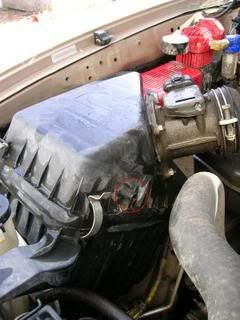

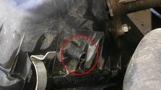

What is this hose supposed to go on? I don't know how long its has been off what every it is supposed to be on. Its been a while since I've been under the hood for more than just checking the fluid levels. Cold winters in NH.
2002 2.7 liter
What is supposed to go here?
Please help.

The first hose should go on a nipple on your silencer box on your main air induction tube. I think I see it in the picture. There should be a nipple between the two horizontal guards.
The second one is the vent connection for the EVAP system. If memory serves there is a pipe that runs along your radiator and it sould be connected to the EVAP canister on the driver's side and a hose that connects to that nipple on the passenger side. I think I see the hose going downward in your picture.

Bingo! Thanks Gadget
324 Posts
yea the first is FPR and should just be connected within the vacuum lines somewhere. and the second is connected via the evap box where Gadget said to.

All that is shown is the fuel pressure regulator and the vacuum sensing hose to the airbox. Nothing involving EVAP.
