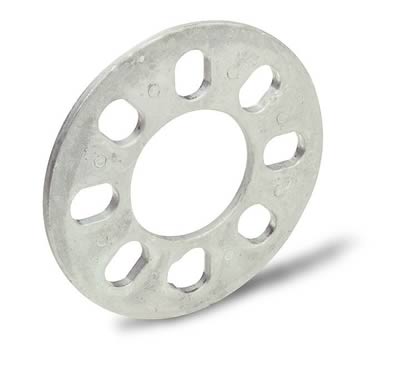

I said 'SLIP OVER' wheel spacers.... :D
This is from Summit racing... $5.39 each.... 1/4" thick... most tire places or any performance shop should have something similar...

Anthony said 1/2" wheel spacer.... the type of spacer you put a picture of only comes in a minimum of 1" width... the amount of the dorman stud 'shank' above the wheel mounting surface is just about an 1/8"... easily cured with the slip-over spacer... and there's plenty of thread for the lug nuts to hold the wheel on... nothing special required... I saw a picture on the AZ SAS board this morning....

I gotcha. I guess there's two issues at hand then. The first one is the stud treads being the same as OEM Toyotas. The second is needing a 1/4" or 1/2" spacer so that the lug nuts don't "run out of thread".
