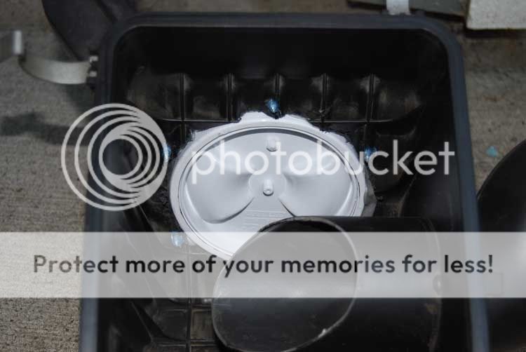

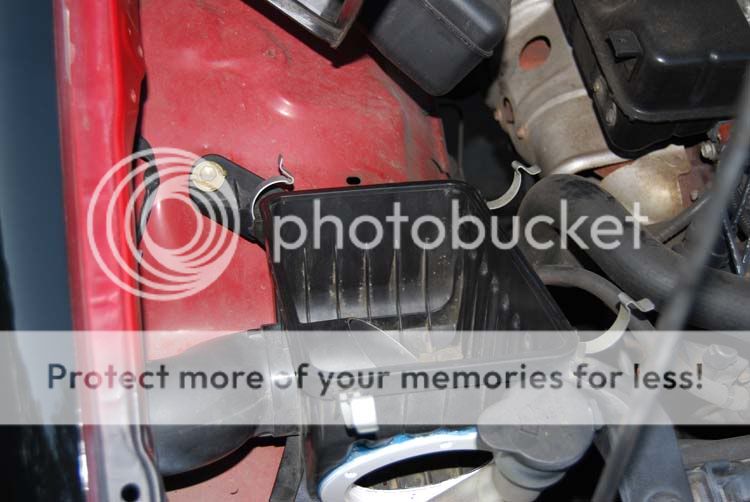

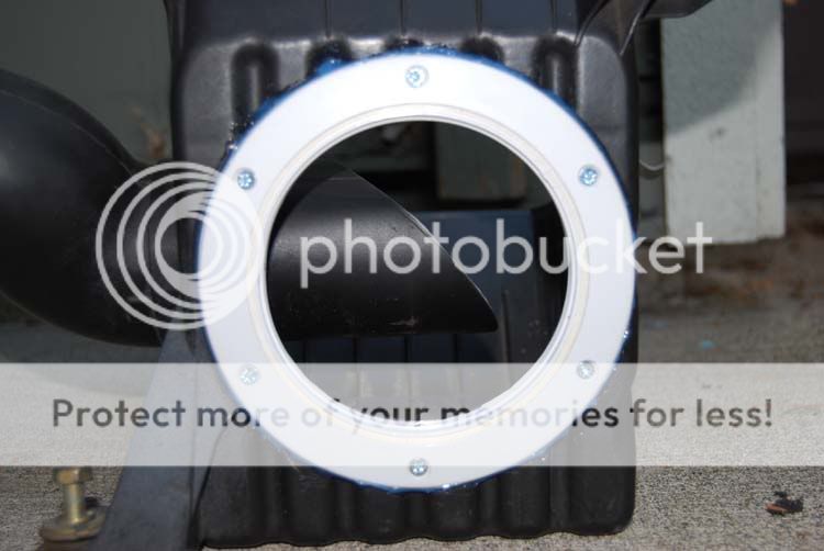

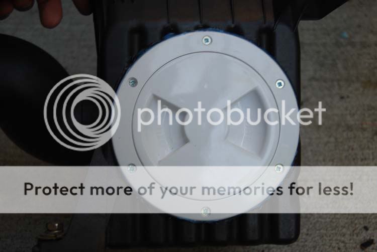

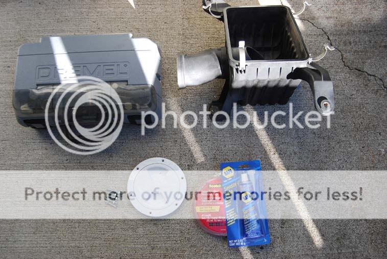

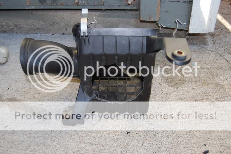

I've seen quite a bit of conversation on here about the DECK PLATE MOD. I'm a member of the WATTORA chapter. There's a write up on the WATTORA site about the 3.4 V6. For those 2.7 folks out there here are some pics I snapped when I did it for my 2.7 I4.
Here's the Deck Plate mod for the 4 banger for people out there wondering if it is doable and what the heck it would look like. I did it in about an hour... Pretty easy. I used a double sided rubber tape to help fill the ridges, and used sensor safe silicone around the edge. A dremel tool makes it an easy job but it can get kinda messy with all of the plastic flying around.
After doing this mod I am definitely a believer... You can feel noticeable gains..
Dremel tool, 4" deck plate(my local boating/marine store...Also on ebay), sensor-safe silicone (auto parts store), and double sided rubber tape to help fill the ridges in the housing.(HOME DEPOT painting section).

It took me about 2.5 hours. I was taking my time cutting out the hole. I didn't want to rush and have it be so big that there would be nowhere to put the screws. Overall it was very easy. I got a little sloppy with the silicone and I probably put too much but I can cut out the excess if I feel like it later on.
I was being cautious cutting out a little at a time. As I got closer to the edges I used a different dremel fitting.
I used this fitting to do the majority of the cutting.
I used this fitting as I got close to the edges so I wouldn't cut too much. This is much more precise.
Ready for the deck plate.
Mucho silicone
All done
A little sloppy
I drove it around a few miles I and was definitely able to notice the difference. It didn't hesitate to lower gears when I punched it. I stayed in gear longer and overall it seems a little faster from the start. Overall the truck feels a lot looser, almost like it's able to breath, finally.
