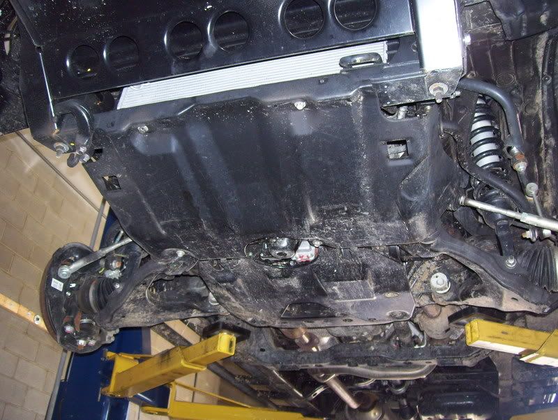

Remove Skid Pans:

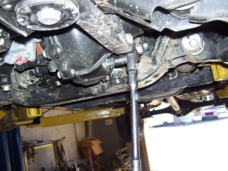

Drain Diff fluid 10mm Allen:

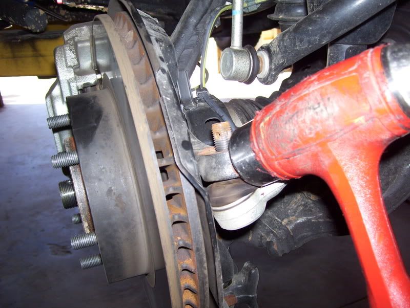

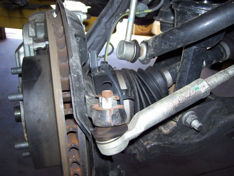

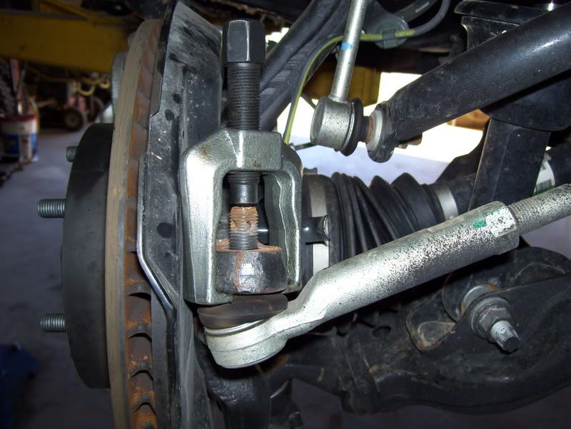

Separate Tie rod ends, a cheap tierod separator can be purchased or rented from an auto parts store or alternately one can use a hammer and give a good smack to the spindle tierod body. Tie rod separator is easy and cheap, do not use a fork tool you will ruin the boot.
Tie Rod Separator:
Hammer method:
