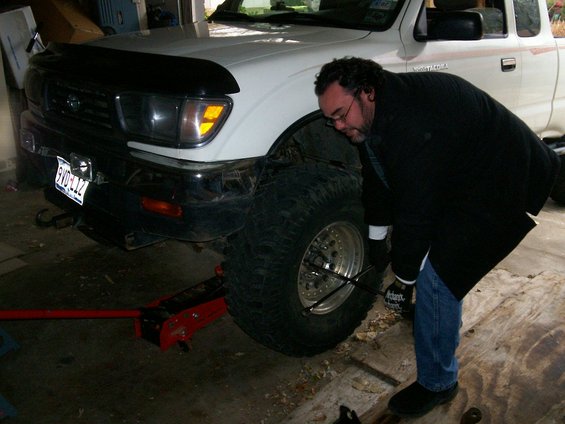

After putting the manual trans in first, engaging the parking brake and chocking the rear wheels, we loosened the lug nuts. Here's my cousin Tony jumping in at that task:

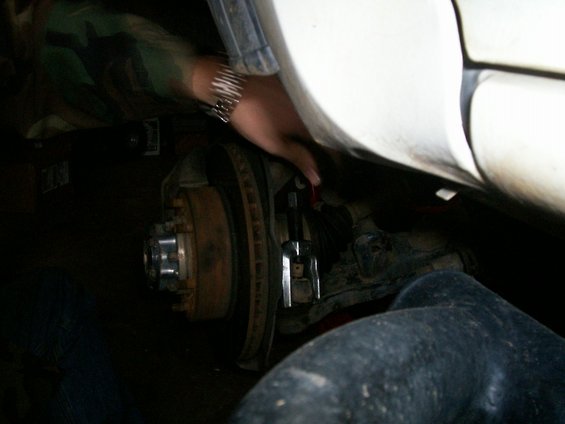

After raising the vehicle with a floor jack and placing jackstands underneath to support the truck, we removed the front wheel and decided to start with the lower ball joint:
Keith began by loosening (but not yet removing) the four lower ball joint bolts (the ones that connect the lower ball joint plate to the lower control arm) and the lower ball joint castle nut (after removing the cotter pin):

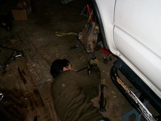

After removing the cotter pin on the tie rod end castle nut, the castle nut was then removed from the tie rod end:
We then fastened a two jaw puller onto the tie rod end threaded stud to press it out:

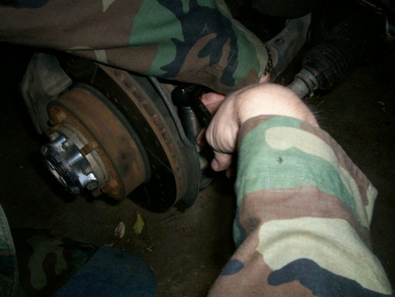

Next, it was time to remove the four lower ball joint bolts and lower ball joint castle nut:
We then fastened a bigger two jaw puller (bigger than the one used for the tie rod end) to remove the lower ball joint:

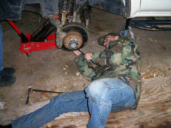

The two jaw puller worked great and easily removed the lower ball joint from the lower control arm. Here's a pic of the old lower ball joint next to the new lower ball joint (pics show the passenger side lower ball joints):

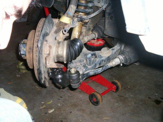

We then installed the new lower ball joint onto the lower control arm. It didn't appear that any additonal pressing was required to install it since it kind of got "pressed in" by tightening the castle nut on the new lower ball joint threaded stud. Here's a shot of it installed with the tie rod end also attached to it:
